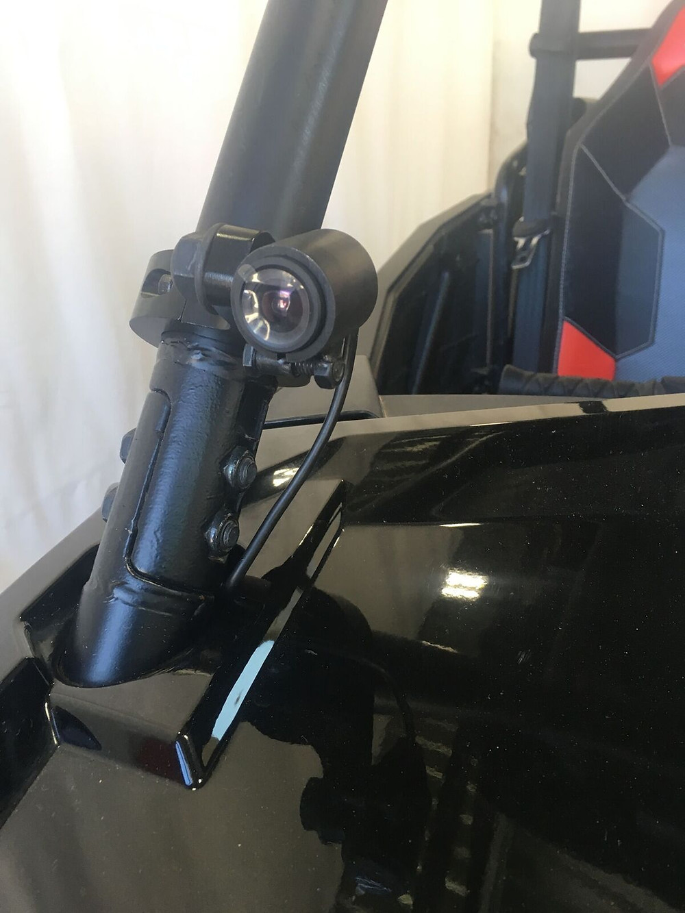

7. Mount DVR Mount, Predrill the holes with a one sixteenth drill bit.
8. Run camera cable from camera location to the DVR. Connect DVR power to the DC Adaptor.
9. Mount DVR.
10. Mount Camera, Set up DVR, Enjoy!
