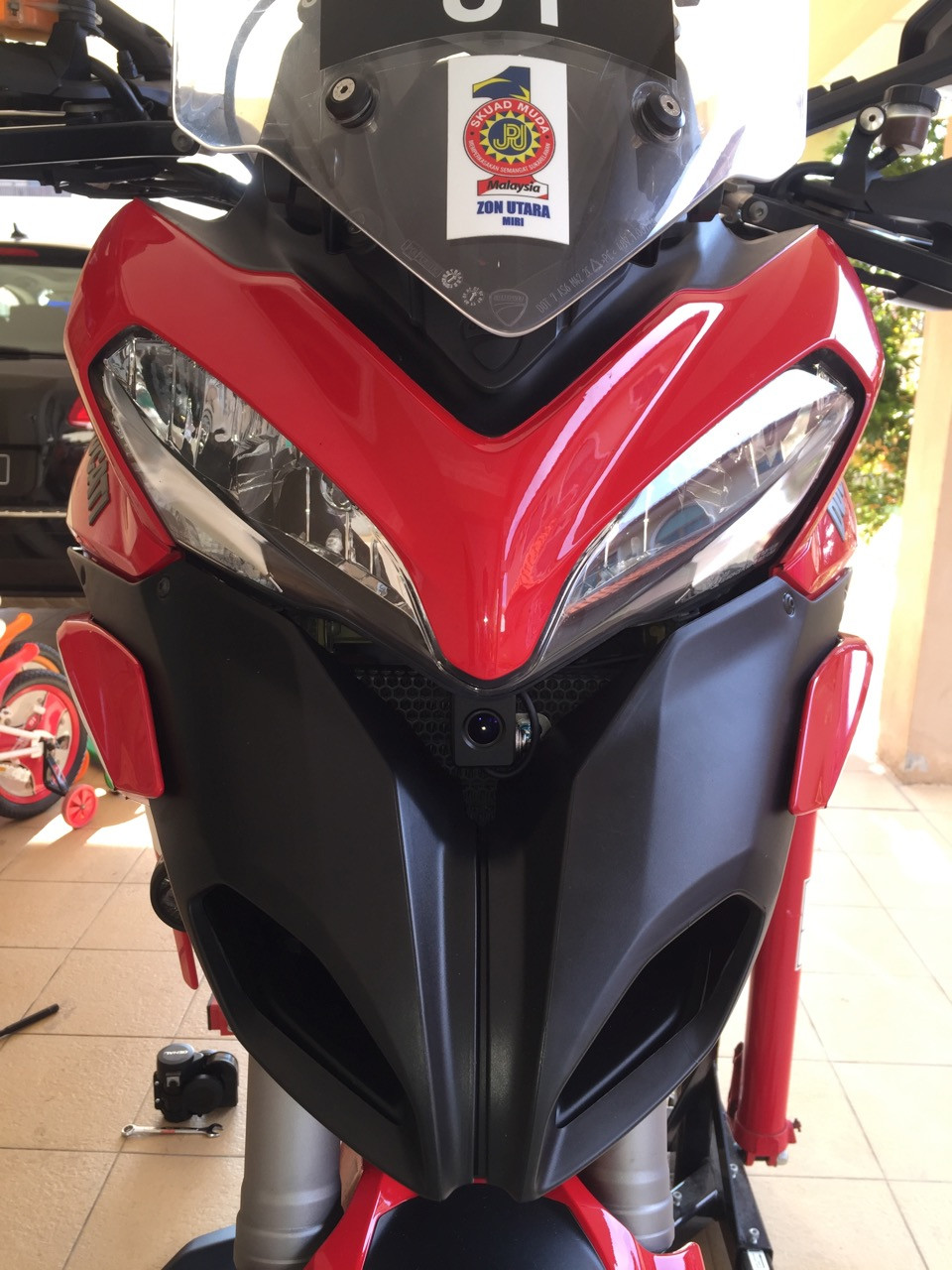

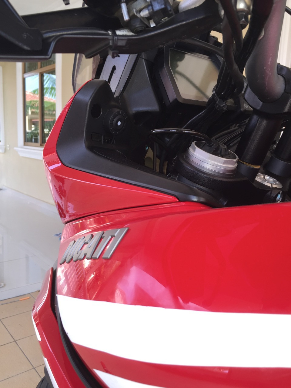

Front camera location.
L-shaped bracket is securely bolted against my Evotech oil cooler protector. It was fixed with the provided 3M adhesive, same location, but underneath the headlamp. But I don't feel secure, and so I redo it with the L-bracket, instead.

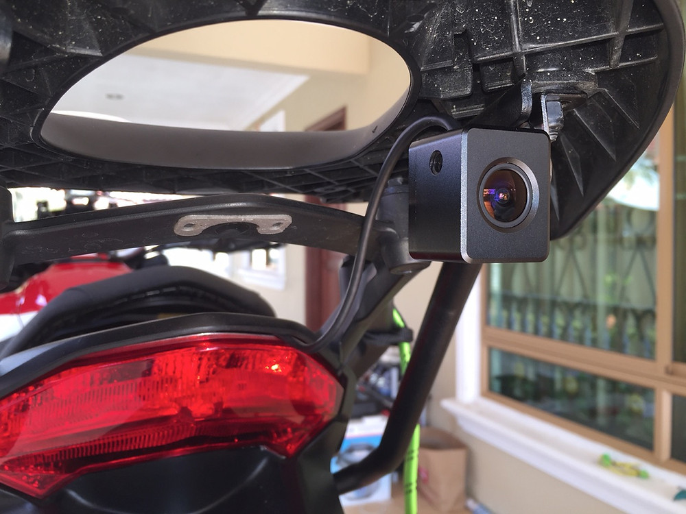

The rear camera is installed beneath my top case mount, secured with the provided L-shaped bracket, as well.

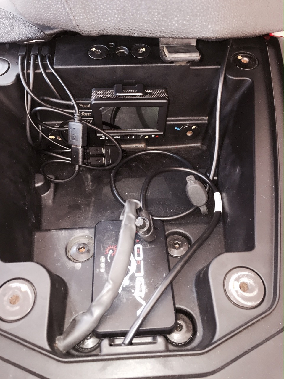

The DVR unit is installed beneath the pillion seat. Due to limited space available from Multistrada itself, this is the only place I could install my additional electronic gadgets.

The power wire are routed to my Eastern Beaver PC8 fuse box which is located under the rider seat. It is connected to the switched fuse, so that the K1 DVR will automatically switched on/off together with the motorcycle.
