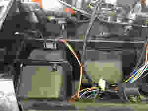

1. Remove dash cover.

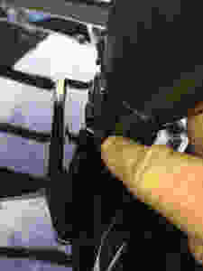

2. Secure DC Adaptor.

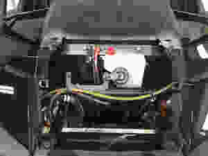

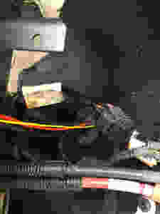

3. Run DC wires through fire wall, secure to the stock wiring.
4. Cut the red, yellow, and balck wires to length.

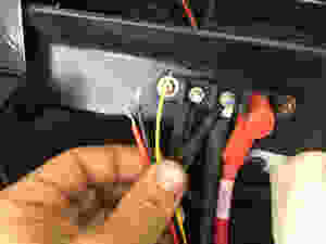

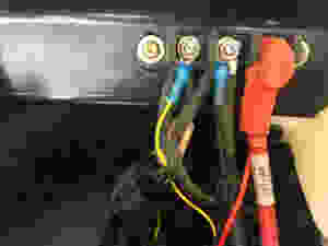

5. Place terminal ends on the wires.
6. Connect wires. Yellow to key on power, Black to Ground, Red to permanant battery positive.
