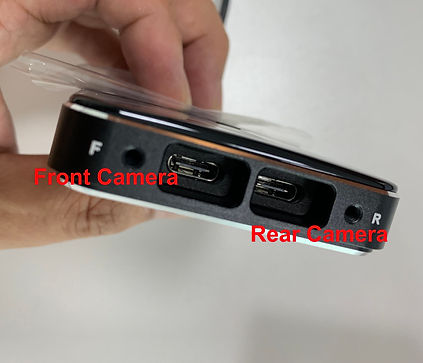

3. Connection & Recording
Refer below photos to set up the K2.
How LED flashes when power supplied.
After few minutes recording, you can check SD card on your PC to see the video clips.

5. Setup the K2 on Motorcycle
Check where to mount front & rear camera, fix DVR, DC converter, GPS module first. and Check how wires can go through.
