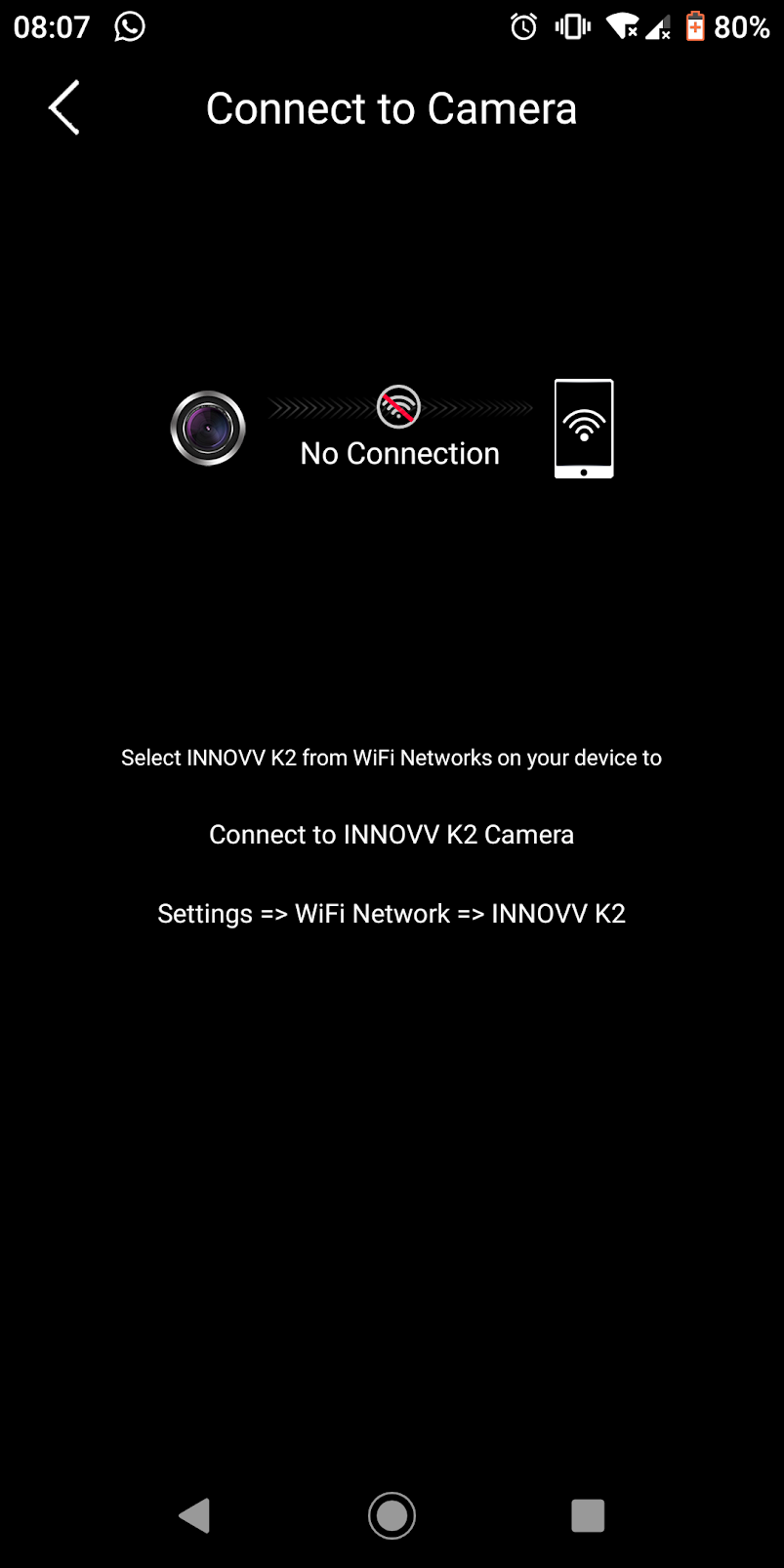

Although it seems to boot, I'm not able to connect to it.
I've got a 2017 BMW R1200GS.
I've got it working through a FuzeBlock FZ-1 (power from battery, and switched power from bike's accessory fuse). Switched power is working properly with ignition on, and it goes off half a minute later when ignition is turned off, as per bike.
When I turn ignition on the unit boots and I can see it's wifi.
I can connect to it without an issue; I get IP address, so all seems good (first tries I had the phone's 3G data still connected, but as per other's experiences, I turned the Data off).
Nevertheless, the app says it's not connected to the K2, so I can't do a thing.

* app didn't connect to K2 claiming phone's network not connected
* Android 9 phone in either airplane mode with WIFI on or as usual (both cases, connected to K2's wifi network)

5) connect app to K2
a) turn airplane on
b) turn wifi on
c) turn location on (no need to have a gps lock)
d) connect to K2's wifi network
e) call application
It worked for me, was based on others partial trials and experiments, so here it goes for anyone that may be in the same boat.

Although the phone connects to it, the app still doesn't recognize the wifi network to the K2 as beeing established, but at least I believe that I can now upgrade the firmware.
