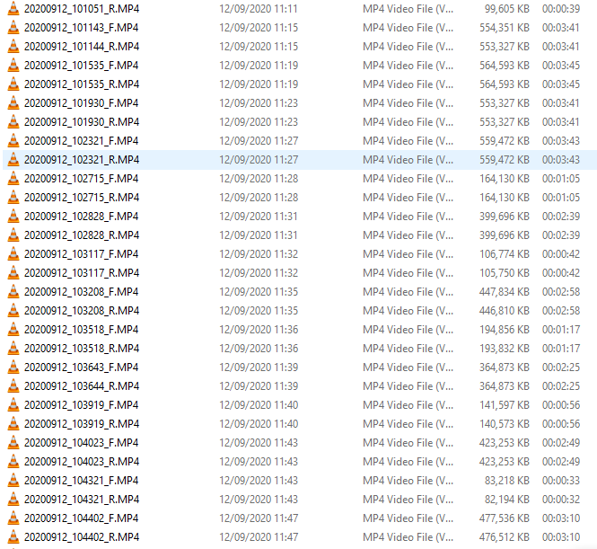

So, you'll notice that my loop video is set to 10 mins, but then look at the video durations of the downloaded files:
There're all over the place, so, what's going on there? Is it the SD Card? It shouldn't be because I've bought the one specified to work (from My Memory so it isn't a knock-off):
The one important clue is that the SD card failed to recognise/format in the K2 the first few times so I formatted it to FAT32 with a formatting programme on my pc and then it worked.
Can anyone suggest the problem? I need a high capacity card as I go on long rides and don't want it over-writing. Cheers.

Thanks both - will try these. On the SD side of things I'd got obsessed that it should be a U3 card, as that's recommended, but given the write speed needed (even with the fantastic-should-be stock increased 20Mb/s bitrate video) is only about 5MB/s, I'll also try my 128GB U1 card.
So, the U1 card (tested with SpeedOutput v0.5) shows: read 80MB/s and write 55MB/s; the U3 card used above is showing: read 80MB/s and write 17MB/s. So, whilst in theory it should be fine, that isn't good. I'll run the h2testw one in a mo and see what it comes back with.
Edit: Correction, I've got two smaller cards - a 64GB one that's a U3 r/w=86/64MB/s, the other one is a U1 but still shows 80/55MB/s. Anyhow, I'll see how the U1 goes (it formatted fine straight off when put in).
Ok, so I reckon it was the SD Card. Even though it's the recommended one the fact that it didn't format itself in the K2 means it didn't work properly. The replacement SanDisk 128Gb U1 card has worked fine today. All as it should be. Thanks for your support.
