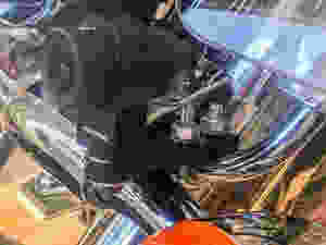

Ok so have the K2 installed mounting on the rear was fairly easy I used the number plate mount bolts and the supplied angle bracket then feed thru with the factory wiring harness around the guard cable could have been 150mm (6”) longer to reach my toolbox where I have placed the main unit. Front camera cable was way to long so zip ties to the rescue.

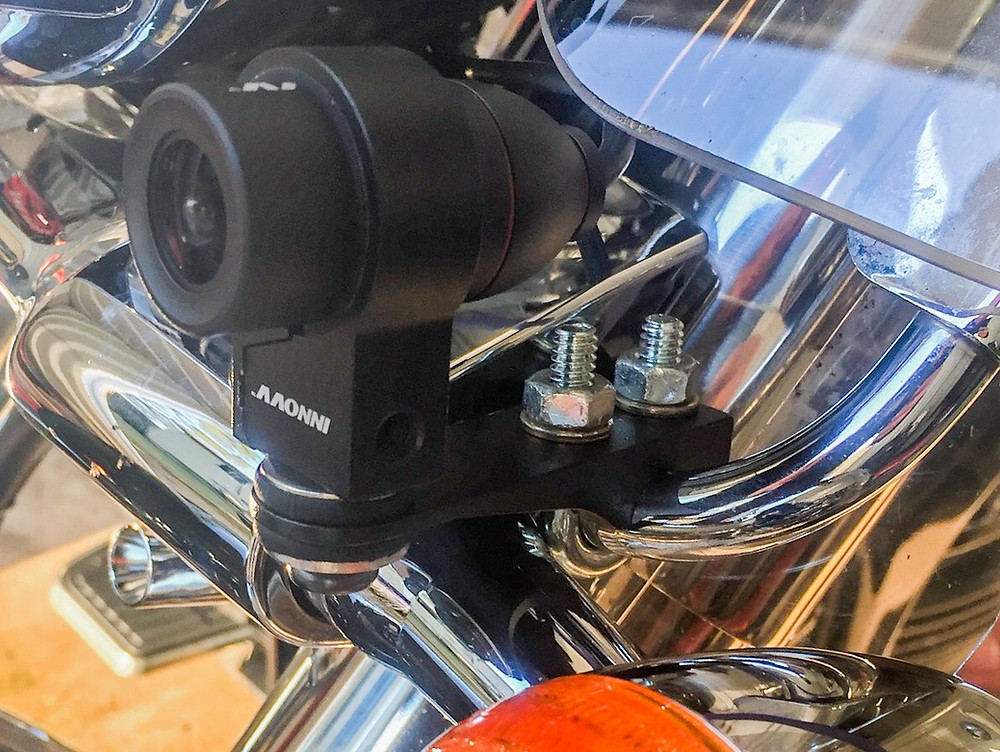

Side view of the front bracket
For ront placement was a bit of a challenge I have made a bracket from aluminium and a 6mm unbolt to secure to wind sheild bracket sprayed the aluminium with etch primer then gloss black. I just get a bit of the guard in the videos but I can live with that overall happy with the result. Going to add some nylock nuts on the unbolt so they don’t rattle lose.

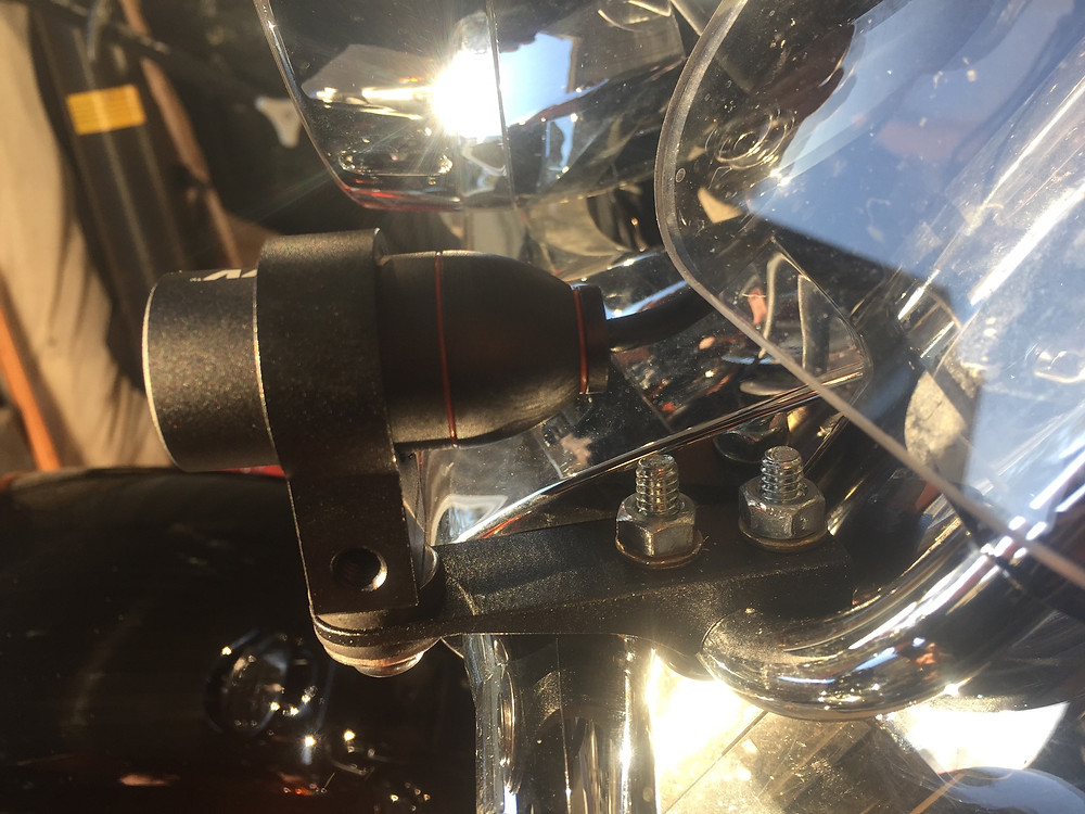

Front side view

The bar mount looks firmly.
What diameter of the bar?
Sep 11, 2018
The bar support for the windshield in 12.5mm a 12mm unbolt fits neatly
Sep 11, 2018
@Brian Aston
The diameter of bar is smaller from the imagination getting from the picture
