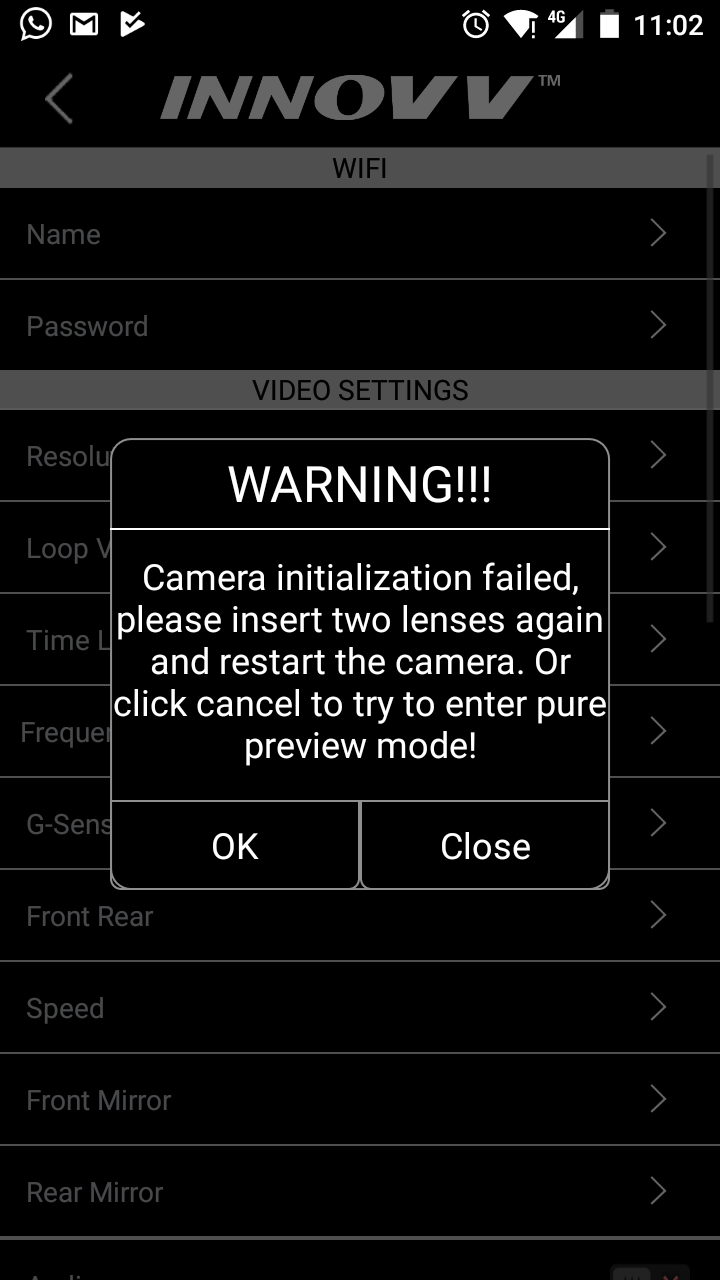

I bought a bike with the k2 I on it .
First the phone app said to update the firmware.(so I did it) Now I can connect to the WiFi off the k2 but once I enter settings I always get this . Does this mean that the cameras are broken?
Thanks for the help
(sorry for my bad English)
It is also necessary to ensure that the location function is enabled during APP use.
Also, you can simply turn off mobile data. You can leave Bluetooth on. This is kind of a problem with Android more than with the Innovv app.
I've got in the habit of turning off the phone's Mobile Data, any time I want to access the K2 over WiFi. Which isn't very often, typically I only need to do that to adjust settings or format the SD card.
Same here, you have to put youre android phone in flight mode and then select the k2 wifi.should connect
