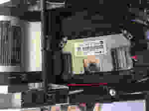

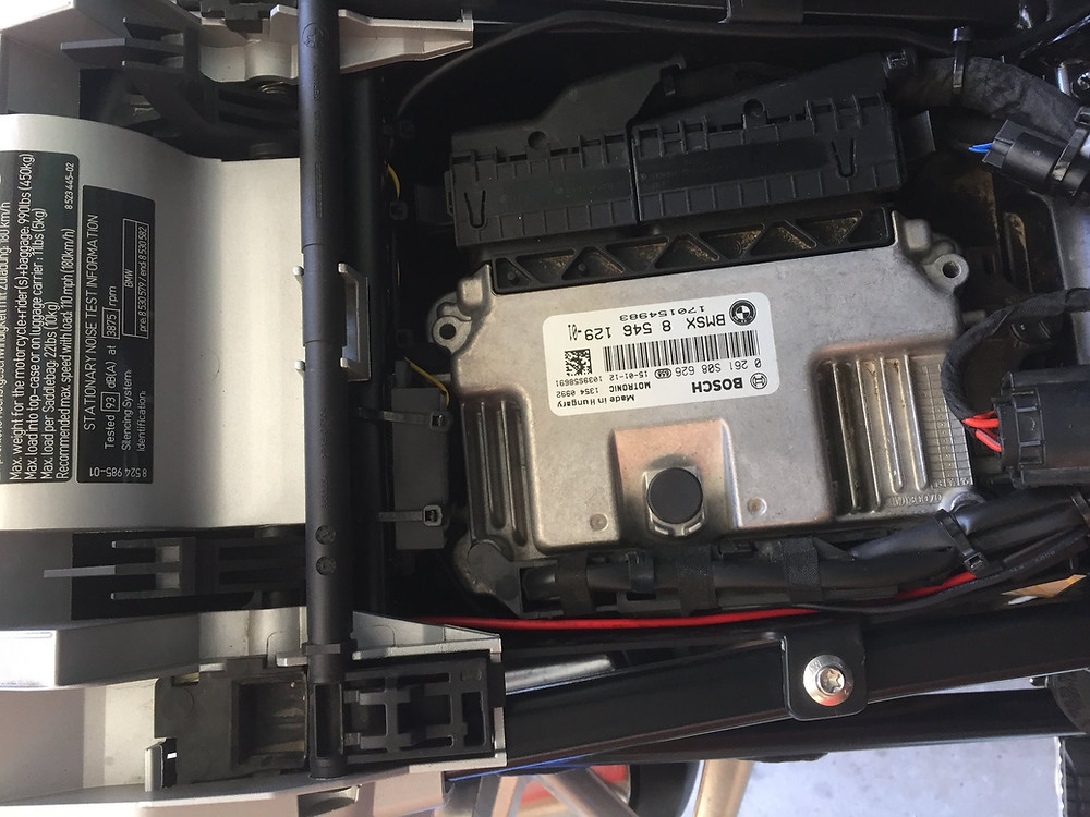

Power supply Installed under the riders seat using Velcro and cable ties.
C5 Installed under the pillion riders seat.
I used a cable tap sourced from Jaycar in Australia to splice the trigger wire onto the tail light wire. The battery wires were crimped...The objective was to have minimal changes to the bike with a neat installation.
